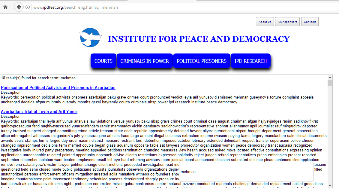

Re: Search results in another page
When I try it, then I do see the results.
Very strange
I only see - "search results"
but not actual clickable results
Chrome, Firefox, Opera - all the same
This is what I see:
