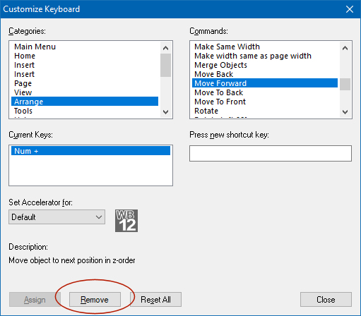

I find + / - keys very unconfortable, because frequently I'm typing normal text and these keys move the lay-out of the page.
Don't you think this is a BUG to fix?
Posts: 14502
Re: Movement of FlexBox and Layout Grids
Post by Pablo » Thu Feb 08, 2018 4:12 pm
This is not a bug. The numpad (+/-) keys were intentionally associated with these actions.
It has been like this since version 1.0. So, if I change this behavior now then I think many other users will get upset.
Note however that you can customize or remove the keyboard shortcuts via 'Customize'.

Post by Bertock » Tue Feb 20, 2018 10:43 am
I keep thinking that numpad (+/-) keys must be deactivated when you are typing a text inside an object.
They must be activated only when you select an object and of course you want to move it.
Posts: 14502
Post by Pablo » Tue Feb 20, 2018 12:06 pm
Keyboard shotcuts are 'system' functionality, they are mapped by the framework. As developer I cannot disable these.
