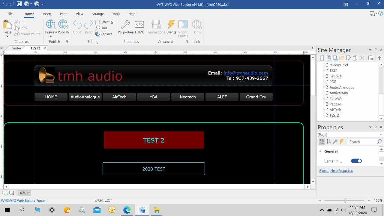

As a longtime "90 Second" user I downloaded the new V16 and trying to migrate my V12 project files on my old PC to my new PC w/V16.
I was finally able to migrate the files albeit without images and established 'trees" - both I can easily fix.
My problem: the project view looks 100% perfect but "Preview and Publish" views screw-up. See attached screen shot links of my "TEST2" webpage:
Project: https://i.postimg.cc/bYMhqcGN/TEST2-Project.png (only the top of page from my laptop)
Preview: https://i.postimg.cc/RF9dzFmJ/TEST2.png
Publish: https://i.postimg.cc/wjkxq48f/TEST2-pub-ished-100.png
I have searched & read threads on this topic but any "solutions" have not worked for me.
Any help & direction will be appreciated as I'm relunctant to publish my entire website until I can get my "TEST2" to format correctly.
Thanks in advance to all replies!
Jim

Re: Project view ≠ Preview/Publish views
I think this is related to the DPI configuration.
Related FAQ:
https://www.wysiwygwebbuilder.com/forum ... 10&t=85917

Thank you, Pablo.
After checking "Enable High DPI support", the Preview is 100% OK but the re-Published site is still having format errors.
New PREVIEW TEST2: https://i.postimg.cc/v8gH41q5/TEST2-Preview2.png
New Published TEST2: https://i.postimg.cc/Gpmbd9T8/TEST2-Pub ... yellow.png
Note the new published webpage has a layer added (as noted by yellow brackets) and green outline/border is missing.
We're getting close!
Thanks Pablo for your help - much appreciated!!!
Jim

UPDATE:
I edited the page to keep info to a bare minimum and hopefully it helps to identify the culprit.
The PREVIEW version is 100% perfect
https://i.postimg.cc/7PnQ7mpr/TEST2-Preview3.png
The PUBLISHED version has added a strangely shaped layer with gradient background. The heading border was changed but that can easily be corrected.
https://i.postimg.cc/zfTkNfNY/TEST2-Publish3.png
As with all previous publishing, "PUBLISH ALL FILES" was chosen.
Additionally, on my old PC with v12, the page published 100% correct. I'll spend some time comparing settings on old PC and new PC.
Thanks for any suggestions & feedback.

Pablo - how do I get the project file to you?
Here is the active webpage: http://www.tmhaudio.com/TEST2.html#
As noted before, I removed all but the basic info so the oddly shaped "layer" that was inserted by the software can be easily seen.
In addition, my project has a narrow green border where the text & content would be placed - this was eliminated in the publishing.
Although the top "heading/border" was also changed a bit, I think I can fix that without much problem.
Thanks so much for your help, Pablo!
Jim Ricketts/tmhaudio

Pablo,
I cleared the image browser cache and re-published...IT WORKS!!! :-)
The strange layer image is gone and the green border has returned...just like on the preview.
Also, the header/border is back to normal 100% OK.
To further test, I inserted two text boxes each with a border - one with a transparent background and the other with a gradient background.
Re-published "all files"
The text now appears but both borders and the gradient background is not visible.
PREVIEW: https://i.postimg.cc/htHV7MVd/TEST2-PREVIEW4.png
PUBLISH: https://i.postimg.cc/ryBdjzKB/TEST2-PUBLISH4.png
Pablo, is there another "cache" that requires to be cleared to get the borders and backgrounds to publish?
Thanks again for your help - so darn close now! :-)
