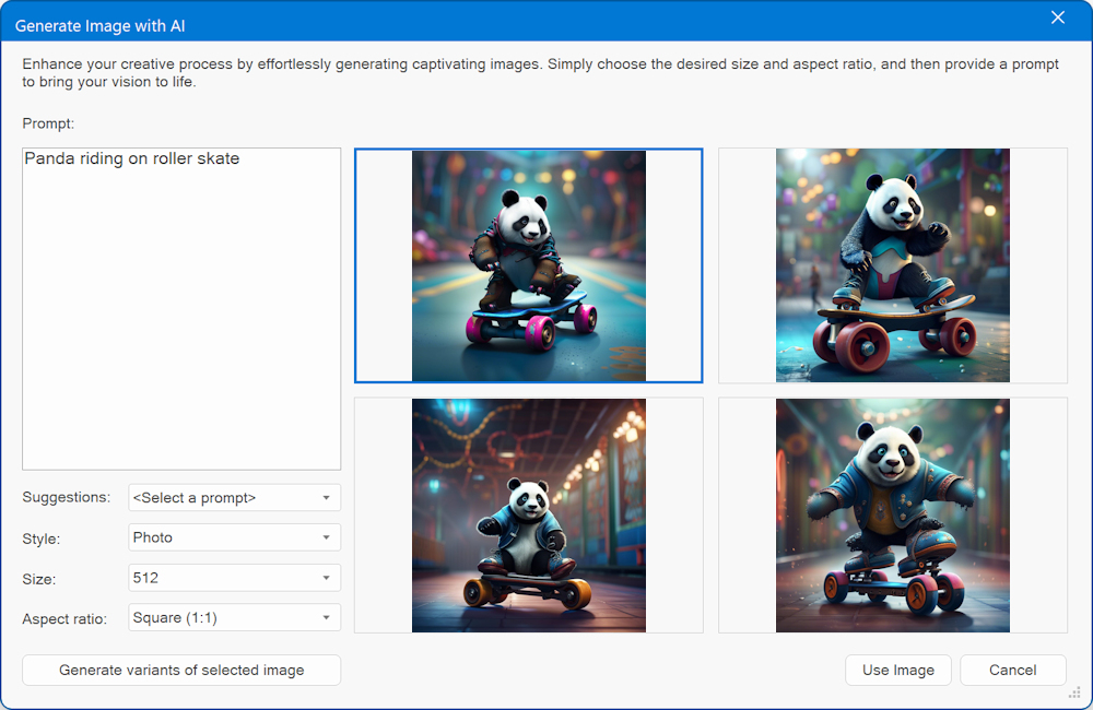

I'm very impressed with some of the new features in WB19, especially the AI image generator. However, the file sizes of the images produced by the generator are generally too large for website use. Is there a setting I could apply that would return compressed images? I also get an error when I try to produce variants of an AI image (because the file size is greater than 4MB). Many thanks for any assistance.

You can set the size in the properties:
https://wysiwygwebbuilder.com/images/ai5.jpg
However, for dali-e 3, the minimum size is 1024

Thanks for your response, I did set the size at the lowest level (256), but the output file was still over 4MB. However, I'm using dali-e 3, so I suppose that's why the files are larger as the minimum size is actually 1024. Is there there any chance you could build in image compression and optimisation in future editions of WB? Many thanks for your help.

Dali-e 3 was released only two weeks, so there was little time to optimize WWB for this model.
But I will investigate if additional options can be added.
Note that WWB already has built-in resample functionality for standard images.
https://www.wysiwygwebbuilder.com/add_images.html
