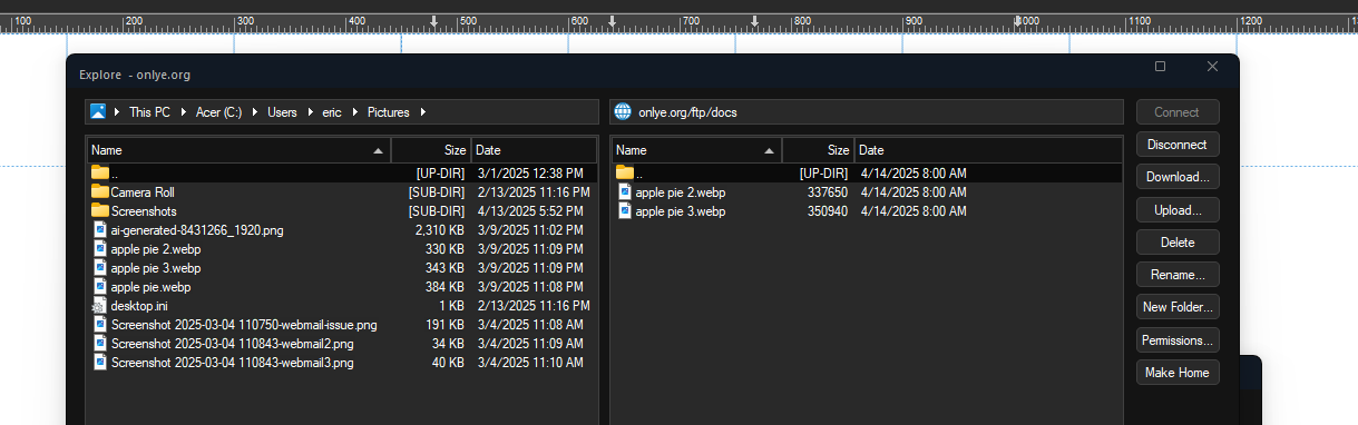

When I use the built in FTP client to Explore and upload files from my local drive to the server I get an error message: Parameter is incorrect.
Behavior:
Files typically are copied to the server
Sometimes, files don't copy
Sometimes, I can close the error and move on
Sometimes, the error keeps popping up, and the only exit is to kill Web Builder (via task manager)
It doesn't matter if I highlight the files and use the upload button or drag and drop the files.

The parameter is invalid error only occurs with Wizzy FTP when I am using the Explore screen to upload files to a sub folder - Publishing website pages is not an issue. I can create new folders and delete and rename files on the server using Explore.
On the server the permission on the folder copying files to is 0755
When transferred to the server the file permission is 0644
Answers to some questions ask:
-Passive mode is checked
-Works with FileZilla
Something new I discovered:
In the dual pane on the right server side the address at the top doesn't match the exact server folder location of the open folder. Most of the time my FTP client is set to a specific folder on the server, not the root location. See image.
The actual location is: onlye.org/postweb/ftp/docs
what shows is: onlye.org/ftp/docs
not sure if this matters or is significant.

I've been testing this for a while using various combinations, but so far, I haven't been able to reproduce the issue.
Additionally, it doesn't appear that the error is being triggered directly by WWB. When a file upload error occurs, WWB typically logs the error in the log window rather than displaying a MessageBox.
Did you also try it on another computer so we can be sure this is not an issue of this computer only?

I have tried multiple files (the ones I showed were bad) with simple names (ftptest.txt) and no spaces or special characters and various types jpg, pdf, xls, doc
There are .htaccess files on the servers. But this happens across multiple hosting companies, multiple servers, multiple domains, so the .htaccess vary
-regarding .htaccess are there any things you suggest i look for being there or being absent?

onlye wrote: Tue Apr 15, 2025 4:22 pm Thanks for suggestions to review. In my most recent round of testing:
I have used FTP Standard and FTP with TLS/SSL (Explicit), choosing SFTP I get errors and no connection, hostgator doesn't support SFTP
According to https://my.hostgator.sg/cgi/help/sftp#: ... 0internet. Hostgator does support SFTP
In general that all the type of file are named correctly lower-case, is it blocking specific files..
Regarding HostGator not supporting SFTP this may only apply if it is on a Windows shared plan or FTP over SSH.
More on this
