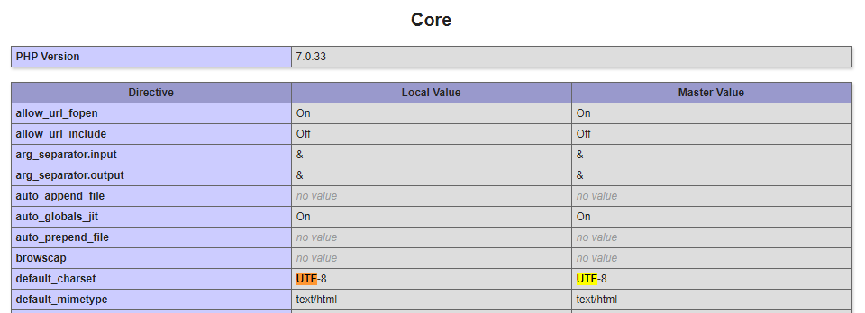

Posts: 3100
Re: Coding of the text not correct
You need to log onto your server, go to the PHP configuration section and look at the php info. The setting is under the core section:

I did a "PHP info" and it was set up to iso-8859-1, so I have told the host to change to UTF-8. We will see what happens...
